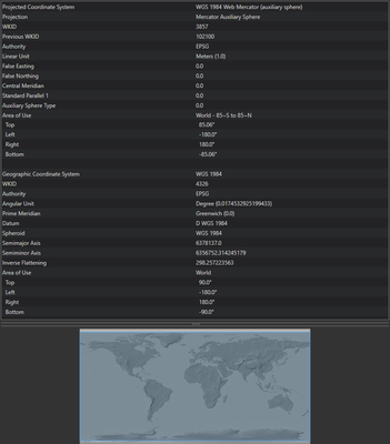

My app is connecting to a web map where the customer's UN dataset is using a custom spatial reference. The resulting coordinate after projection is off a very small amount causing coincidence/connectivity to not occur.
Source:
Target:

After using the default transformation, I am left with the following results:
- After Projection:    X=-10656077.1980003, Y=3392011.73970032
- Expected Value:    X=-10656077.2082,        Y=3392011.728
- X Value Difference:        0.010199720039963722
- Y Value Difference:         0.011700315400958061
- Esri Feet Default Buffer: 0.003281
My experience with spatial references and datum transformations is lacking so I'm not sure if my issue is with the custom spatial reference my client is using OR if I need to define and use a custom transformation. Any advice would be greatly appreciated.
