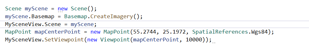

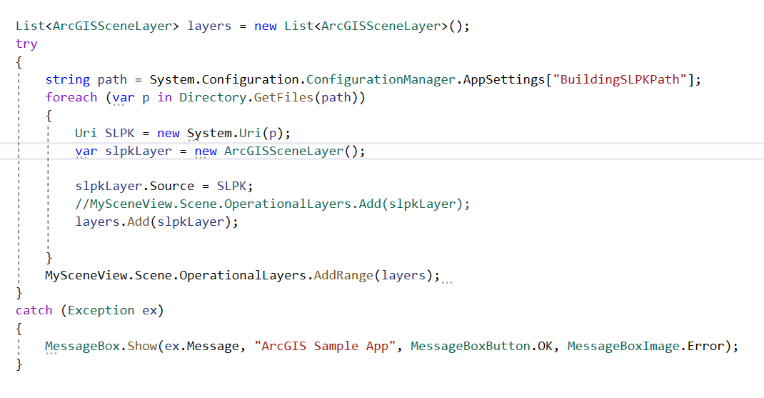

I am developing an WPF application that load multiple local SLPK files using ArcGIS Runtime Dot Net SDK.
Each SLPK have buildings, highway roads, vegetations and trees.
I have 64 GB RAM with Good Graphics Card PC.
But still loading speed is very slow.
My code is given below
 Please give us advice
