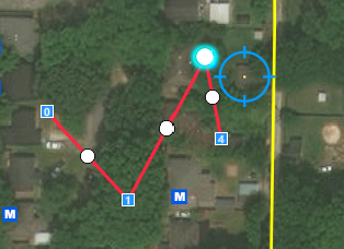

Sketching:
Drag vertex 2 to M point manually:

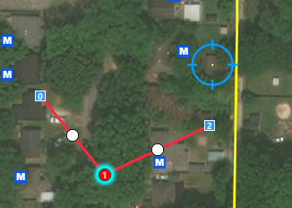

Undo:

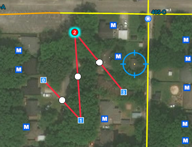

Move selected vertex to cursor using MoveSelectedVertex:

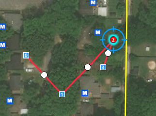

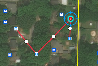

Undo of MoveSelectedVertex (moved vertex gets deleted)

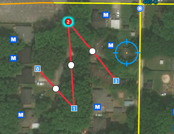

If I call Redo, it gets put back where it was:
