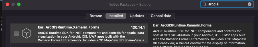

I am using ArcGIS Runtime 100.14.1

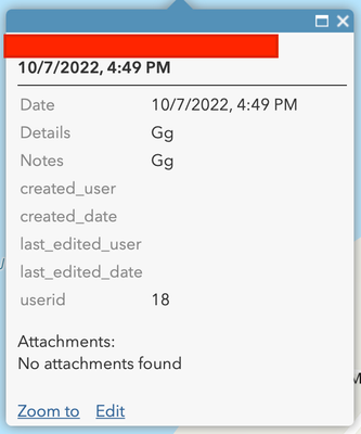

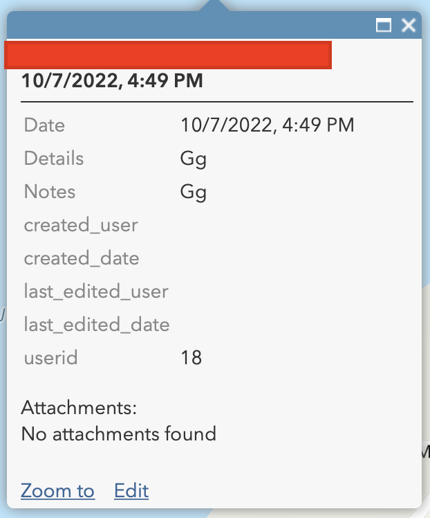

When I check the Map in ArcGIS Online map viewer I do not see the attachments.
Is this a known issue?
Any suggestions would be very helpful.
