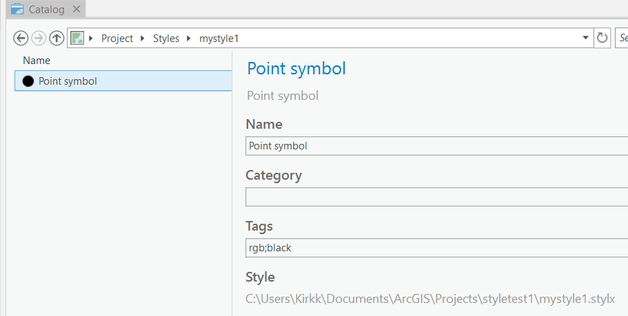

In Pro 2.2.4 I created a new stylx file which has just one symbol in it, a black dot.
With .NET sdk 100.4, I try SymbolStyle.OpenAsync for this file I get:
Invalid argument: Invalid or Missing densifyCurves value.
Expected value is: true
Is this a bug?

The stylx should be created as a mobile style in ArcGIS Pro. If not, geometries in symbols can contain curves (like in the circle from your screen shot) and that’s currently not support in ArcGIS Runtime (hence the validation error).
If you have an existing stylx that has not been created for mobile, you can copy/paste the content into a new mobile stylx and that should fix the symbols.
