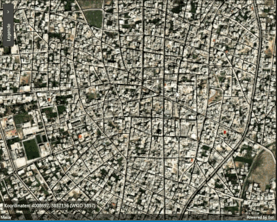

TimScheiber
Hi, the selected features are inside the visible area. I've attached a GIF that shows how the selection changes when the visible area is updated:
