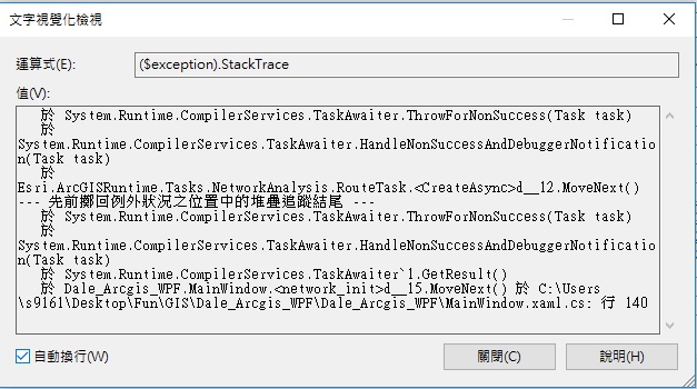

I got the error when creating RouteTask with .geodatabase(which downloaded from http://www.arcgis.com/home/item.html?id=bd441813cd2f4c8891aee671a65feb54) :
Esri.ArcGISRuntime.ArcGISRuntimeException:
(error massage is [Internal error:(the name of geodatabase)] )
stack trace of error
(error stacktrace)
this error also happended to .geodatabase which I created from ArcMap(I try it in both 10.3 and 10.5).
P.S. My ArcGIS Runtime SDK version is 100.4
What should I do?

It looks like your network name is not correct for that dataset. Instead of "Local_ND" try "Streets_ND" for the network name.

Oh, thank you for your suggestion. I solved this problem. (I thought that network name was used to display and can be customized. Any way, thank you a lot.)
