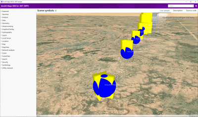

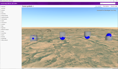

I'm trying to anchor it at the center. This does not appear to work, either by AnchorPositioner.Center or AnchorPosition.Origin.
It seems clear that both Center and Origin should work the same. Here I've added this .obj file to my scene with its AnchorPosition set to Origin; I've also added a text label "0" at the given point and also I have a cone with AnchorPosition.Top which has its top set to the same point. In this case, the SymbolSizeUnits are set to Meters, and width == height == depth.
Obviously this is not correct. The origin is in the center of the cube. Here I'll try AnchorPosition.Center:
This looks right, although I've had problems with this when the points aren't as regular as this. So that looks correct.

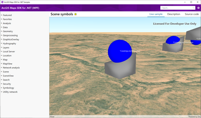

Now we'll try SymbolSizeUnits.Dips, AnchorPosition.Center:
Now we're anchoring to the bottom again for some reason. This behavior is different for SymbolSizeUnits.Dips vs. SymbolSizeUnits.Meters, but shouldn't be.
Now I'll try SymbolSizeUnits.Meters, AnchorPosition.Origin:
This is anchored to the bottom too. It doesn't appear that I can do anything to actually anchor at the center in SymbolSizeUnits.Dips mode. It always appears to use AnchorPosition.Bottom instead.

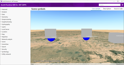

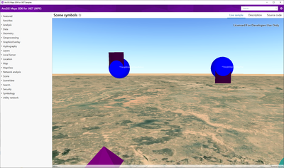

1. In Dips mode, nothing is anchored correctly. If you zoom in far enough, the model will always diverge from the actual point in some way. Here you see a Dips cube and a Meters sphere (anchor point is Center). The cube is sticking out the bottom of the sphere when it should be centered in the same place as the sphere.
Here, the anchor point is Bottom, and you can clearly see that the model is not attached to the anchor point, which is given the same point as the Meters-based sphere:
Here it's anchored to Top, and you can see daylight between the actual anchor point and the model:

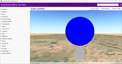

2. Origin and Bottom appear to be nearly the same in Dips and Meters modes. I have seen them diverge, but rarely, and Origin has nothing to do with the origin of the model under any circumstances in any model format I've tried (and I tried a lot of formats). Here's a cube which is centered at 0,0,0 in Dips:
And here it is in Meters:
Both are incorrect in the same way. No point of origin is respected in any of the tests I did, moving the origin around a cube model. The Origin anchor point definitely does not anchor at the origin, it's still similar to or the same as Bottom, and the Center is still using an algorithm that's difficult to figure out. It seems to be maybe a weighted average of face area, I think. Vertices that aren't part of a face are not considered, I know that much.

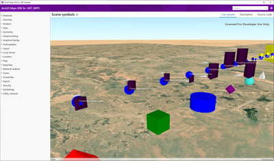

3. Much less important, but I can't do your SimpleMarkerSceneSymbols in Dips mode. It would be very nice to be able to create a cone, sphere or cube in Dips mode. I assume this is possible but was missed in the API or something.
Generally speaking the SimpleMarkerSceneSymbols make sense in terms of how they work (though I'm still confused about how Center is calculated). Here I plotted them in a similar way to the other models:
Their anchor points seem to work as desired, generally speaking. Their Origin anchor points clearly work differently than all other loaded models, since they seem to actually be in the center of the models, and I haven't seen any other case where I could get that to happen. If I could get the same behavior for loaded models I'd be very happy, though I can't test their behavior in Dips mode.

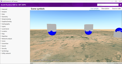

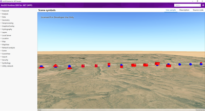

This is better in that the top and bottom stay attached to the point now in DIPS mode:
But the origin point is still not respected, which makes it basically impossible to put a non-symmetrical model where I want it, unless your algorithm happens to pick the center I want.

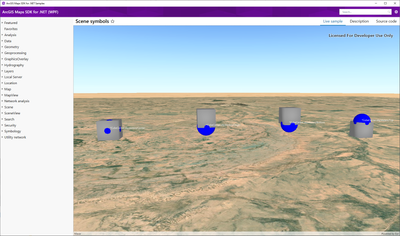

This is a cube from a .obj file where the origin is in the center. The sphere is centered on the anchor point, and the SceneSymbolAnchorPositions are, from left to right, Center, Origin, Bottom, Top:
This is a cube where the origin is at one of the corners, same deal, SceneSymbolAnchorPositions are, from left to right, Center, Origin, Bottom, Top:
