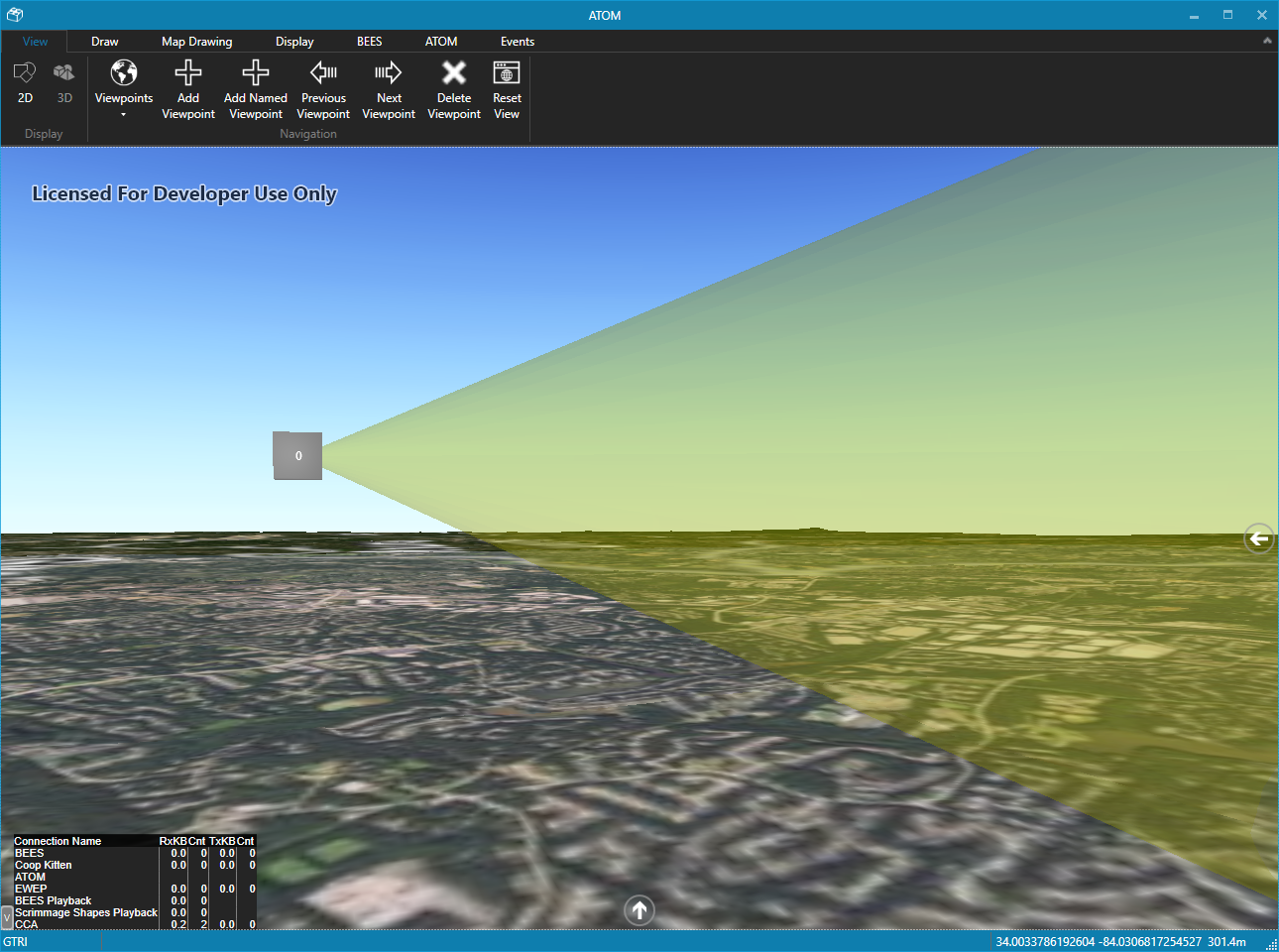

I'm trying to anchor it at the center. This does not appear to work, either by AnchorPositioner.Center or AnchorPosition.Origin.

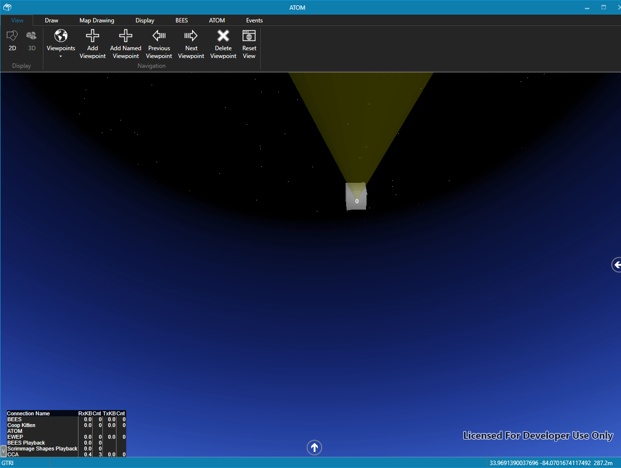

It seems clear that both Center and Origin should work the same. Here I've added this .obj file to my scene with its AnchorPosition set to Origin; I've also added a text label "0" at the given point and also I have a cone with AnchorPosition.Top which has its top set to the same point. In this case, the SymbolSizeUnits are set to Meters, and width == height == depth.
Obviously this is not correct. The origin is in the center of the cube. Here I'll try AnchorPosition.Center:
This looks right, although I've had problems with this when the points aren't as regular as this. So that looks correct.

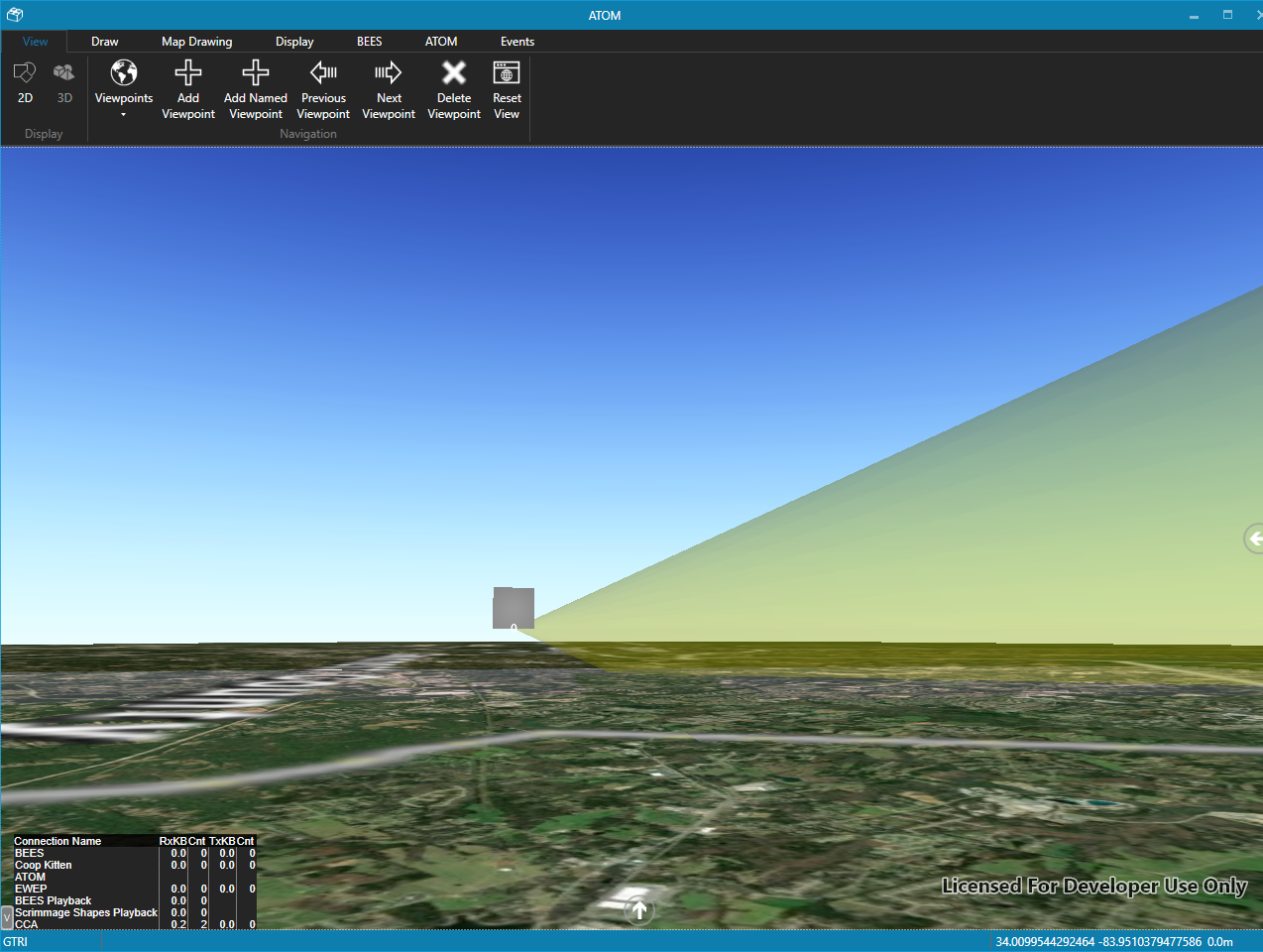

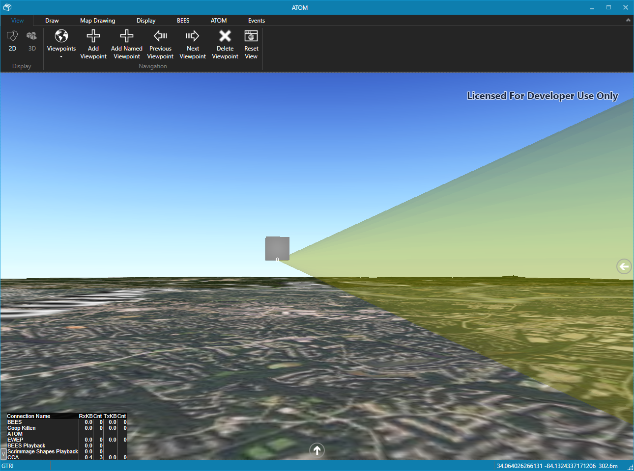

Now we'll try SymbolSizeUnits.Dips, AnchorPosition.Center:
Now we're anchoring to the bottom again for some reason. This behavior is different for SymbolSizeUnits.Dips vs. SymbolSizeUnits.Meters, but shouldn't be.

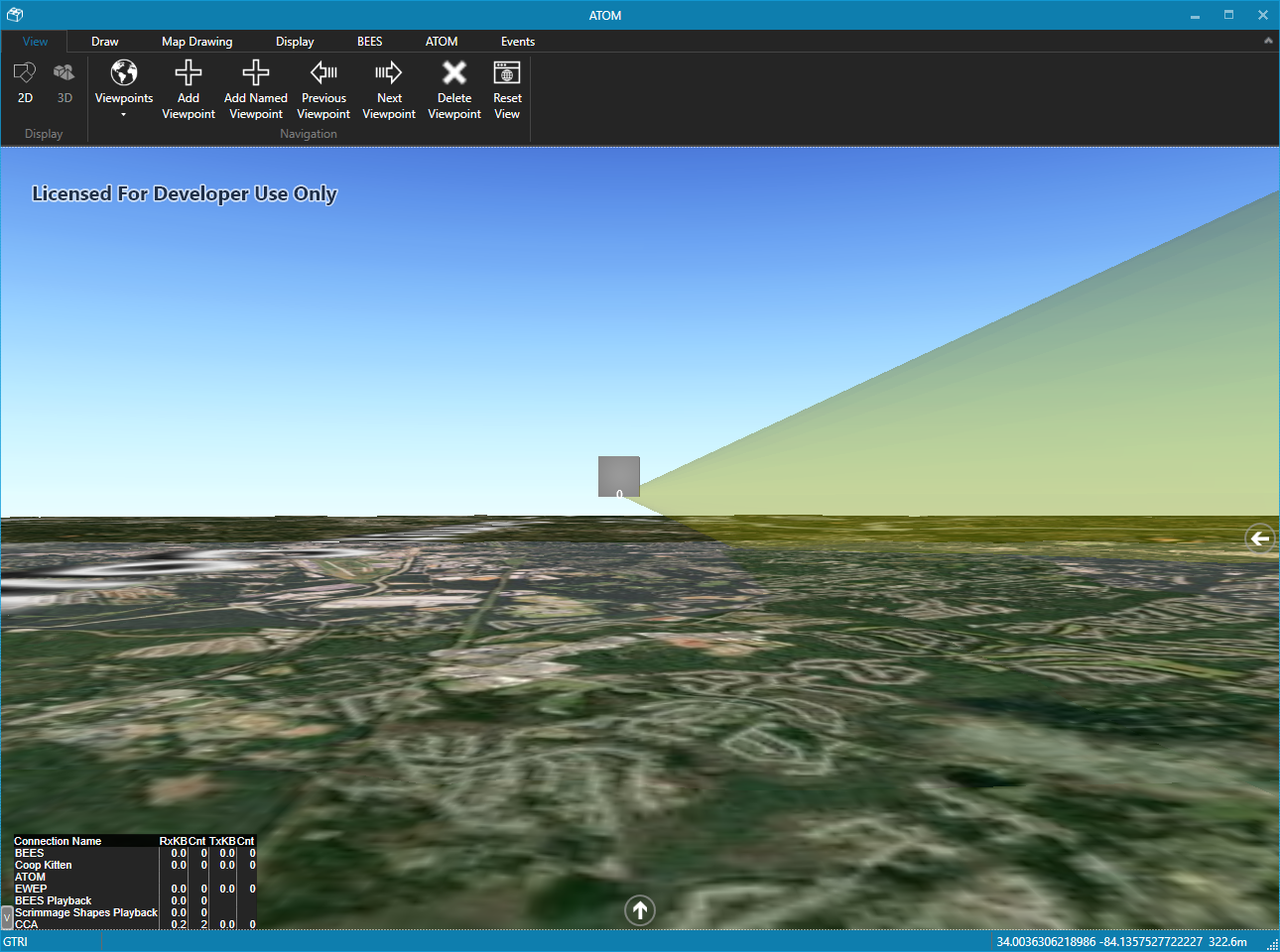

Now I'll try SymbolSizeUnits.Meters, AnchorPosition.Origin:
This is anchored to the bottom too. It doesn't appear that I can do anything to actually anchor at the center in SymbolSizeUnits.Dips mode. It always appears to use AnchorPosition.Bottom instead.

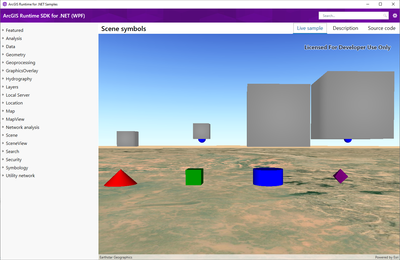

I've modified your Scene Symbols example to demonstrate the issue. Simply place my Cube.obj in the Resources folder when you execute the example app to test.
Here I've added a sphere using SimpleMarkerSceneSymbol in four locations, and added a ModelSceneSymbol of my cube .obj file in each of the four combinations above (meters/center, meters/origin, dips/center, dips/origin). I've attached the modified source file.
You can see that despite the center and the origin of the Cube.obj being the same, the behavior is not consistent:
Again, the order in this picture is meters/center, meters/origin, dips/center, dips/origin.
The only one that acts correctly is meters/center.
Meters/origin and dips/origin anchor to Bottom instead.
Dips/center however is an odd case. I've attached a video showing the strange behavior. When I zoom in, it moves off the center point and down, probably related to where the camera is. I can't imagine it represents the intended behavior.
Please let me know if there's a way to use AnchorPosition.Origin and have it work properly with .obj files. I'd really like to be able to anchor in the right place; otherwise it makes 3D models inaccurate to use.

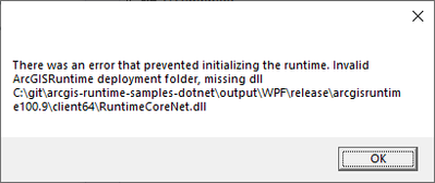

I figured out the problem. It was twofold -- first, it builds in Visual Studio 2019 but not in Visual Studio 2017. Up to 100.8.0 at least builds in Visual Studio 2017, or maybe I have different components installed in the different versions.
Second, I assumed the master branch was the right one. I didn't realize there was a main branch. The master branch is still on 100.9.0, but the main branch is up to 100.10.0.
Once I switched to Visual Studio 2019 and the main branch it worked.
