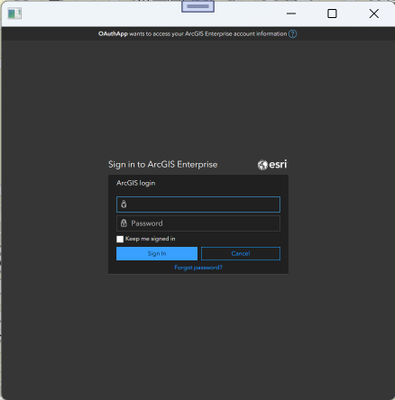

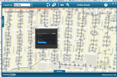

I am setting up an app in WPF.  In the past all Windows WPF apps I have deployed have used Windows or SAML authentication and so have never had an actual login dialog.
Setting this app with standard ArcGIS Enterprise credentials and the dialog looks very poor.  The returned login is very small.  Is there any way to change this size?  I don't see anything that allows that control.  But this looks very poor

It looks like there's a scaling factor issue at play, comparing to the text size in the browser window behind it.
Are you using the newer Webview2 browser? Or the older IE7 based one that is built into WPF?

The dialog is hosted by the portal you're accessing and as such is just the size of the HTML returned by the server. Generally I'd use a smaller window to host the HTML content to better match the HTML content returned.

I can shrink my window so there is not as much blank space but it is really small.  And very different size from how it renders on a web page.

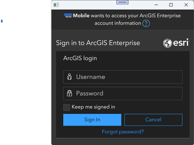

Ended up being basically the same.  The one 'trick' was that you cannot use the Navigate methods on the WebView2 but need to set the Source property
_webView.Source = new Uri(authorizeUri);
The WebView2 needs to initialize, and getting the initialization methods to work was giving my fits.  But setting Source will also call the initialization methods in the background.  Much better look
