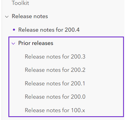

And click the "prior release notes" in the TOC to go through the history of changes:
