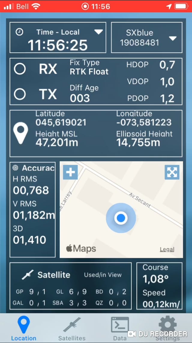

I am using Runtime 100.16 in an iOS application.  Using the NmeaLocationDataSource.  When using the external application we see RTK Float fix type and I would expect to see the same in our application.  I can see that we are receiving the NTrip source stream, but there seems to be an issue in the writing.

They have an app called SX Blue Toolbox, which when connected and running is providing a RTK Float or better fix and that is seen in the application.  Most of the iOS stuff I have seen is in Objective-C (I think I saw a swift one).  So is hard to compare things directly.

To receive RTK corrections it is necessary to have a SXbluePlatinum with multifrequency, multignss and RTK activations so that it can receive and process the corrections it receives via NTRIP with SXbluetoolbox, otherwise it will remain in RTK Float without fixing the position.

Hi Joe, if you use an sxblueGPS receiver you can download the SXbluetoolbox app from the iOS or Android app store and use it to process RTK corrections via NTRIP, the corrected data will be available in an app like Esri Collector, or Esri Fieldmaps in real time.
Next I leave a link showing how it works.
https://vimeo.com/447174493
Thank you
