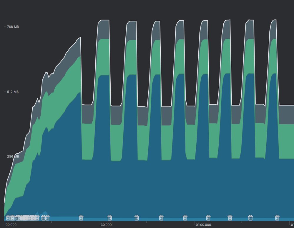

@SokoFromNZ I have not been able to reproduce the memory leak in an Android emulator.  After switching pages repeatedly, I see memory change by at most 2 MB per cycle:
I ran your latest updated reproducer, build with ArcGIS Maps SDK 200.3.0 in VisualStudio 17.9.3.  Are you still able to reproduce this with latest-stable versions of MAUI workloads?  Could it be that one of the recent MAUI service releases (8.0.6 or 8.0.7 or 8.0.10) plugged the leaks that affected this project?
BrianLoehr
Side question - what memory tool generated this image?

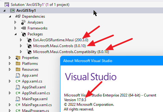

I am using the VS versions you mentioned:
I am using the plain/standard API34 emulator coming with VS2022:
