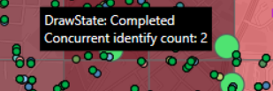

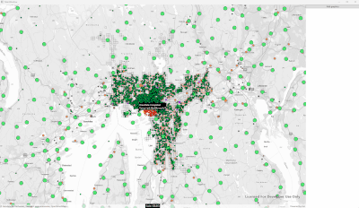

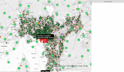

Thank you for getting back to me. I've extended the sample a little bit.
  • New button for adding graphics to graphics overlays so graphics can be identified
  • Press Control key to identify on mouse move
  • Updated to 200.6
New and old discoveries (see screenshot)
  • when using control and mouse move, the drawstate flips between InProgress and Completed continiously
  • Sometimes when using control + mouse move to identify, the queue keeps increasing and is never processed
  • Sometimes the application crashes. I've seen that in our application in particular when identifying graphics while DrawState is InProgress. Most easily reproduced when zooming in to get map InProgress, and then keep control key down while moving the cursor to on and off a diamond symbol.
  • I see AsTask is used in many different areas of the application, such as Locators and FeatureService. If the cancellation/blocking can be fixed for identify, I also imagine we can have benefits in other areas of the application when it comes to cancellation.
Updating both toolkit and SDK to 200.6 removes the binding error
