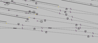

Hi,
In my application I am using multilayerpointsymbols to create complex symbols. Sometimes one of these layers may even contain a simplemarkersymbol.  This is for example useful if the symbol should contain one or more circles, connected by lines for example.
Below code shows how I use the simplemarkersymbol combined with multilayerpointsymbols. This used to work fine. For readability I simplified a bit of the code. In the actual code I read symbol geometry elements from a JSON file, but that will be harder to analyze.

When updating to runtime versions above 100.11 the symbols are no longer visualized in the map. Though they are still 'renderable', as I am able to visualize them as a separate picture in a non-map environment using the "GetSymbol" function.
Has anybody else run into this problem? Did the SDK change on this subject?

stuartkerkhof
Hi Priyanka,
Good questions. The testsymbol code I provided also does not visualize. only in the legend:
but not in the map.
I should add that uniquevalue renderer is not part of a graphicsoverlay, but a featurecollectionlayer.

I understand it is hard to troubleshoot without all the code. However the code is quite extensive and depends on multiple files. The above is a summary of what I think the most relevant calls are.
while writing this I saw that I define a reference scale, and that I scale the symbols. When I disable that part, the symbols visualize again:
this is not a definite solution ofcourse, as scaling is necessary, but I guess the problem is in the scaling department. Maybe something to do with the newly added "ReferenceProperties" attribute of symbols?
stuartkerkhof
 I tried numerous variations for the ReferenceProperties:
also with min/max scale reversed. But that does not seem to be the cause.
Only when setting the referencescale of the view the symbols become invisible. I use this to keep symbols the same actual size, regardless of the zoom in level of the user.

stuartkerkhof
Hi Priyanka,
thanks for trying. But this does not seem to solve the issue.
In your code I see you're adding a unique value renderer. But you're not doing anything with it. The symbol is directly added to the graphics overlay. In my code, symbols are loaded at runtime using a uniquevaluerenderer to load the appropriate symbols with specific feature properties ( "attributes").
I tried only setting the map scale view, but that only changes the scale of the view at a certain moment. Reference scale sets the symbols to a constant "real life" size. as stated in the SDK docs: " // The reference scale of the map is the scale at which a client should view the
// map for the feature symbols and text to appear at their authored size.
// If the client changes the viewing scale, then feature symbols and text will grow
// or shrink to keep a consistent size on the map (not the screen). This only happens
// if the reference scale is greater than zero and for feature layers that have
// Esri.ArcGISRuntime.Mapping.FeatureLayer.ScaleSymbols set to true, otherwise the
// symbols and text stay at their authored size."
this is the desired behavior for me.
I have tried setting the reference properties of the symbols exactly as in your example, but that doesn't work.
By the way, In my original code I never used the referenceproperties property of symbols. This was only introduced in runtime 100.12. I'm only trying it out now because I thought this might be a part of the solution.
Isn't there any way you can check out the actual SDK code and figure out what was changed with regards to referencescale and simplemarkersymbol conversion? It seems to me something is going wrong with the conversion of a simplemarkersymbol to multilayerpointsymbol.
kind regards,
Stuart

Hi Priyanka,
maybe this helps. I've attached the complete code. You can see how I'm using unique value renderers to specify which symbols to load for specific features.
Also the method "testSymbol" is included, that is the symbol we've been talking about as an example. You can see I set the reference properties at all points. Also when I don't set any referenceproperties, it does not work.
when the featurecollection is completed, and the featurecollectionlayer is loaded, the following code is executed.
        private async void FeatureCollectionLayer_Loaded(object sender, EventArgs e)
            GeographicMapViewModel geographicViewModel = GeographicMapView.DataContext as GeographicMapViewModel;
            MapservicesViewModel mapservicesViewModel = geographicViewModel.MapservicesControl.DataContext as MapservicesViewModel;
            GeographicMapView.BackgroundGrid.IsVisible = false;
            geographicViewModel.FeatureCollectionLayer.Layers[0].ScaleSymbols = false;
            for (int i = 1; i < geographicViewModel.FeatureCollectionLayer.Layers.Count; i++)
                geographicViewModel.FeatureCollectionLayer.Layers[i].ScaleSymbols = true;
            GeographicMapView.Map.ReferenceScale = 445;
            await GeographicMapView.Map.LoadAsync();
            GeographicMapView.Map.OperationalLayers.AddRange(mapservicesViewModel.ListMapservicesList);
            GeographicMapView.Map.OperationalLayers.Add(geographicViewModel.FeatureCollectionLayer);
            MeasureToolbar.SelectedLinearUnit = MeasureToolbar.LinearUnits[4];
            _ = await GeographicMapView.SetViewpointCenterAsync(geographicViewModel.FeatureCollectionLayer.FullExtent.GetCenter(), scale: 10000);
            _ = await GeographicMapView.SetViewpointScaleAsync(445);
            LoadWindow.Loading = false;
            LoadWindow.Visibility = Visibility.Collapsed;
PreetiMaske
Priyanka tried in Android and it works. Then in tried in .Net I see above symbol created with exact code you provided, just changed the coordinate collection to an array of MapPoint and added a graphic to graphics overlay that uses this symbol and it all works fine.
