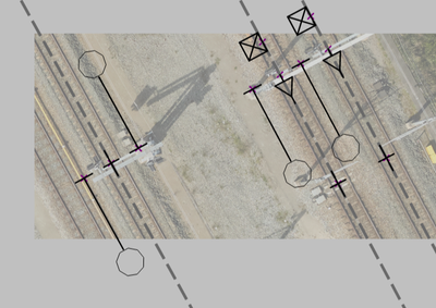

Hi,
In my application I am using multilayerpointsymbols to create complex symbols. Sometimes one of these layers may even contain a simplemarkersymbol.  This is for example useful if the symbol should contain one or more circles, connected by lines for example.
Below code shows how I use the simplemarkersymbol combined with multilayerpointsymbols. This used to work fine. For readability I simplified a bit of the code. In the actual code I read symbol geometry elements from a JSON file, but that will be harder to analyze.

When updating to runtime versions above 100.11 the symbols are no longer visualized in the map. Though they are still 'renderable', as I am able to visualize them as a separate picture in a non-map environment using the "GetSymbol" function.
Has anybody else run into this problem? Did the SDK change on this subject?

stuartkerkhof
Hi Preeti,
thanks for trying. I saw that the order of your code is somewhat different than mine. So I changed my code to make it more similar.
that didn't provide a solution.
however, I did some new debugging, and finally figured out what the problem is. RenderingMode can somehow not be set to "Automatic" or "Dynamic". When I change it to 'static' it works as before.
I don't know why this is happening, and I don't believe this is by design (right?)
anyway, thanks for putting me on the right track 🙂
conclusion, for now:
Setting map reference scale only works with renderingmode set to "Static".
kind regards,
Stuart

    SolidStrokeSymbolLayer lineSymbol = new SolidStrokeSymbolLayer(1, Color.Black);
    List<SymbolLayer> symbolLayers = new List<SymbolLayer>
            lineSymbol
    MultilayerPolylineSymbol multilayerPolylineSymbol = new MultilayerPolylineSymbol(symbolLayers);
    List<MapPoint> mapPoints = new List<MapPoint>();
    MapPoint[] coordinatesArray = new MapPoint[] { new MapPoint(0, 0), new MapPoint(5, 0), new MapPoint(5, 2), new MapPoint(5, -2) };
    foreach (MapPoint coordinate in coordinatesArray)
        mapPoints.Add(coordinate);
    VectorMarkerSymbolElement symLyrEl = new VectorMarkerSymbolElement(new Polyline(mapPoints), multilayerPolylineSymbol);
    List<VectorMarkerSymbolElement> vectorMarkerSymbolElements = new List<VectorMarkerSymbolElement>();
    //add custom element to vectormarker symbol
    vectorMarkerSymbolElements.Add(symLyrEl);
    SimpleMarkerSymbol pointSymbol = new SimpleMarkerSymbol(SimpleMarkerSymbolStyle.Circle, Color.Transparent, 5)
        Color = Color.Transparent,
        Outline = new SimpleLineSymbol(SimpleLineSymbolStyle.Solid, Color.Black, 1)
    pointSymbol.Style = SimpleMarkerSymbolStyle.Circle;
    MultilayerPointSymbol multilayerPointSymbol = pointSymbol.ToMultilayerSymbol();
    VectorMarkerSymbolElement vectorMarkerSymbolElement = new VectorMarkerSymbolElement(new MapPoint(0, 10), multilayerPointSymbol);
    //add circle symbol to vectormarker symbol
    vectorMarkerSymbolElements.Add(vectorMarkerSymbolElement);
    VectorMarkerSymbolLayer symLyr = new VectorMarkerSymbolLayer(vectorMarkerSymbolElements);
    List<VectorMarkerSymbolLayer> vectorMarkerSymbolLayers = new List<VectorMarkerSymbolLayer>();
    vectorMarkerSymbolLayers.Add(symLyr);
    MultilayerPointSymbol sym = new MultilayerPointSymbol(vectorMarkerSymbolLayers)
        AngleAlignment = SymbolAngleAlignment.Map,
    var sr = SpatialReference.Create(4839);
    var map = new Map(sr);
    map.ReferenceScale = 445;
    mapview.Map = map;
    var UVrenderer = new UniqueValueRenderer()
        RotationExpression = "[RotationField]",
        RotationType = RotationType.Arithmetic,
    UVrenderer.FieldNames.Add("Asset_Type");
    UVrenderer.UniqueValues.Add(new UniqueValue("Asset_Type", "Asset_Type", sym, "whatever"));
    UVrenderer.DefaultSymbol = new SimpleMarkerSymbol(style: SimpleMarkerSymbolStyle.Cross, Color.Red, size: 10);
    Graphic g1 = new Graphic();
    g1.Geometry = new MapPoint(0, 0);
    g1.Attributes["RotationField"] = 140;
    g1.Attributes["Asset_Type"] = "whatever";
    _graphicsOverlay.Graphics.Add(g1);
    Graphic g2 = new Graphic();
    g2.Geometry = new MapPoint(0, 0);
    g2.Attributes["RotationField"] = 140;
    g2.Attributes["Asset_Type"] = "whatever2";
    _graphicsOverlay.Graphics.Add(g2);
    _graphicsOverlay.Renderer = UVrenderer;
    _graphicsOverlay.RenderingMode = GraphicsRenderingMode.Dynamic;
    _graphicsOverlay.ScaleSymbols = true;
