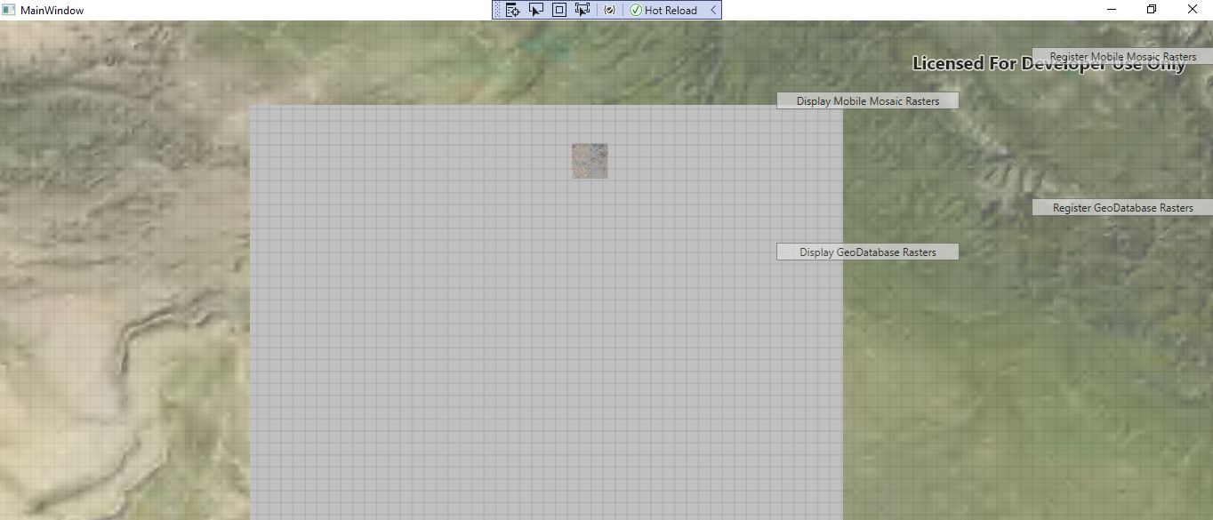

Hi,
I have registered 2 tiles ('world.JP2' & 'mycity.jp2') using mobile mosaic dataset raster.
However as soon after loading the mosaic datasets, I try to zoom on mycity.jp2 raster, this artifact appears.
Also speed of map rendering is very slow as compared to devexpress mapview control using .png tiles. How can I solve these issues?

Interestingly while registering rasters, If I set these 2 parameters then this artifact disappears but map loading is still slow.
parameters.MinPixelSizeFactor = 0.01;
parameters.MaxPixelSizeFactor = 1;
(I m unable to find documentation regarding these 2 parameters, Can you explain them as well please).
Update: I have now converted mycity.jp2 in tiles (approx 100 tiles) but .prj file (which has extent information) is not loading.
