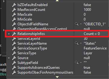

I created a new MMPK after this relate was created.  When you debug in runtime:

Looking at the geodatabase table States within the MMPK, the relationships collection is empty. This either indicates it's a problem packaging or perhaps an issue with the way the relationship was set up?

 "relationships": [],
I'll let the support analyst know (Jose).
