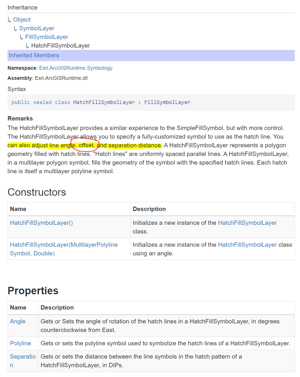

Hi, as I am trying to create a MultilayerPolygonSymbol with two vertical lines of different colors I am unable to find property Offset inside HatchFillSymbolLayer class. Documentation says that I can modify it but I can't find it and without it lines overlap each other.

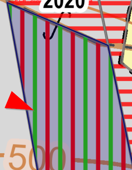

What I want to achieve is red and green vertical lines inside polygon:
I am using Arcgis SDK for .NET with Xamarin.Forms and WPF. Any advice appreciated.

Hi @TomasSchwandner , thanks for your question.
Sorry for the confusion in the documentation. Currently this property is not exposed, however we have a bug logged internally to look into this.
If you're looking for a workaround for now, you can publish symbols with an offset in ArcGIS Pro and we will honor the offset in the ArcGIS Maps SDK for .NET.
