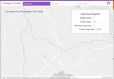

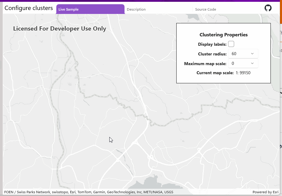

I am adding a context menu to my WinUI MapView and noticed a weird behaviour:
After every right-click on the map, the next left-click-and-drag does not pan the map. Panning only works on the second left-click-and-drag.
The next left-click-drag is only ignored if I right-click-tap the map, not if I right-click-drag the map. Other events like GeoViewTapped are always fired as expected.
The issue can be reproduced in the Sample App (ArcGIS Maps SDK for .NET Samples (WinUI))
Steps to reproduce:
1. Right-click on the map (press and release)
2. Left-click and drag to pan
3. The first drag does not pan
4. Repeat left-click and drag => panning works.
I have attached a GIF demonstrating the issue (blue = right-click, yellow = left-click and hold).
