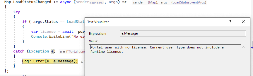

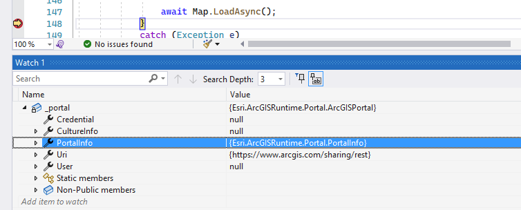

The issue is that even though I am logged in and can load layers without issue the _portal object does not seem to hydrate completely.  There is no PortalUser on the object, and if I try to get a license it fails saying the user cannot

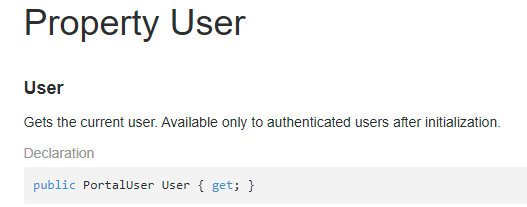

According to help
At this point the user is authenticated because the maps have loaded, load status is Loaded.  Also if I try to get a license it fails
Which is not true, the user does have access to a Standard Runtime license.
