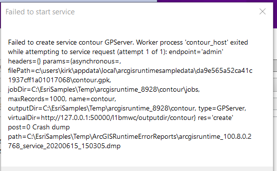

Is anyone able to turn on logging, or get the Contouring sample gp service to work?
Local Server Utility shows Enable Logging is checked.
However, when I click Start Local Server on the sample here, VS shows "Logging disabled" in the output window:
Licensed For Developer Use Only
'apppid' = '26784'
'cleanuponshutdown' = ''
'enablehtmlviews' = ''
datadir does not exist, creating: "C:\EsriSamples\Temp\arcgisruntime_8928"
DataDir : "C:\EsriSamples\Temp\arcgisruntime_8928"
Message : Logging disabled
AppDataLocalDir : "C:\ESRISA~1\AppData\Local"
AppDataRoamingDir : "C:\ESRISA~1\AppData\Roaming"
AppDataCommonDir : "C:\ESRISA~1\AppData\Common"
MyDocumentsDir : "C:\ESRISA~1\AppData\Documents"
CrashDumpPath : "C:\EsriSamples\Temp\ArcGISRuntimeErrorReports"
The Map Service and Feature Service work as expected, however the GP service presents this:
The C:\EsriSamples\Temp\arcgisruntime_8928\contour folder exists, but has no files.
There are no log files. Attached is dmp file.
Same result when running as admin.

Hi Kirk,
When did you grab the repo? A fix was merged to the samples on June 12 via Local Server 100.8 by ZackAllen · Pull Request #802 · Esri/arcgis-runtime-samples-dotnet · GitHub .
