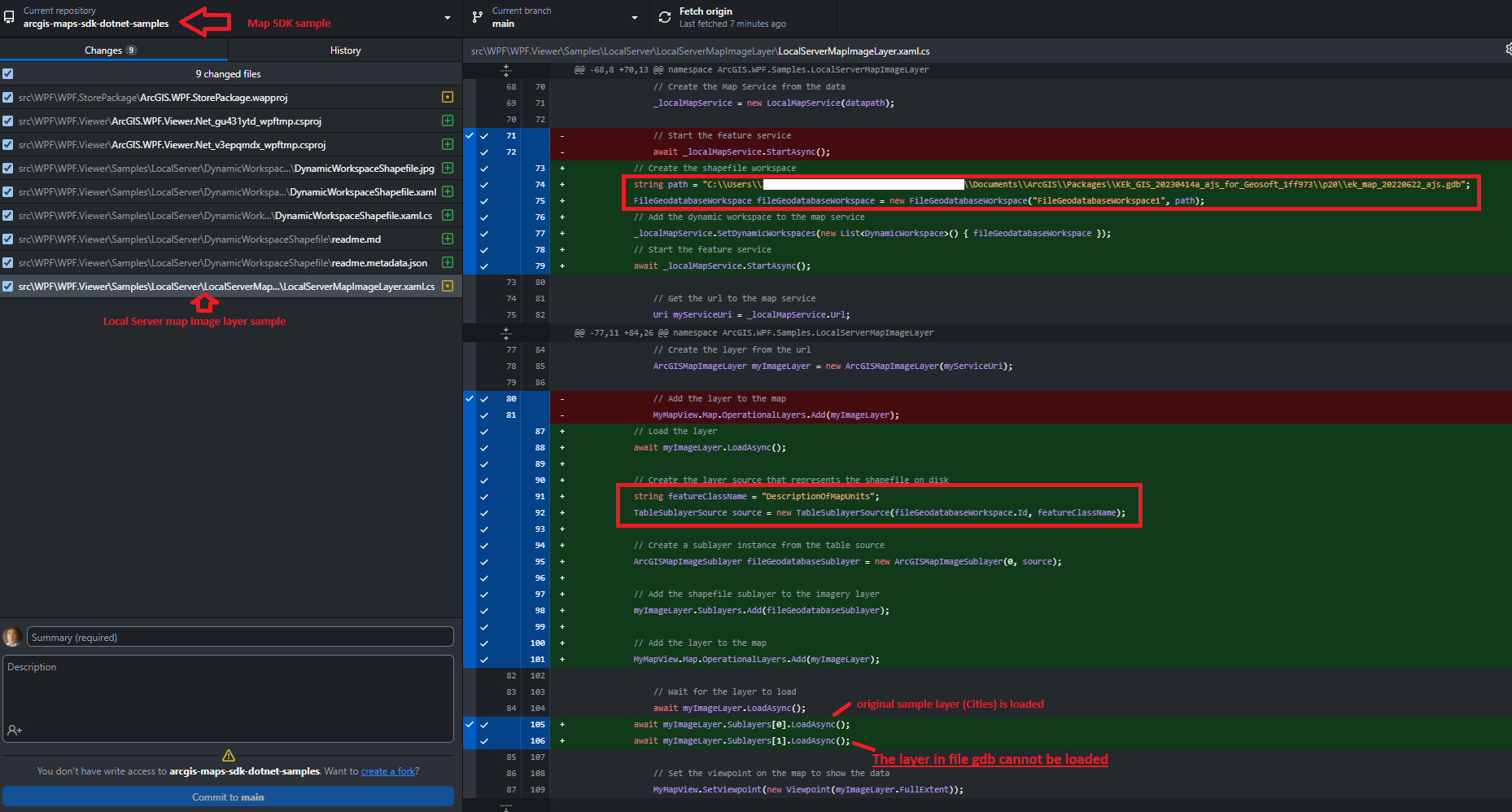

2) I try to update the "Local Server Image Map Layer" sample to load the FileGDB as the following
But I got the following error at line 106.
Esri.ArcGISRuntime.Http.ArcGISWebException
HResult=0x00000000
Message=Unable to find the specified 'dataSourceName' in 'dataSource' for dynamic dataLayer with 'id': 0.
Source=Esri.ArcGISRuntime
StackTrace:
at Esri.ArcGISRuntime.Http.HttpDispatcher.<SendAsync>d__14.MoveNext()
at Esri.ArcGISRuntime.Internal.RequestHandler.<IssueRequestAndRespond>d__4.MoveNext()
at ArcGIS.WPF.Samples.LocalServerMapImageLayer.LocalServerMapImageLayer.<Initialize>d__2.MoveNext() in D:\others\arcgis-maps-sdk-dotnet-samples\src\WPF\WPF.Viewer\Samples\LocalServer\LocalServerMapImageLayer\LocalServerMapImageLayer.xaml.cs:line 125
This exception was originally thrown at this call stack:
[External Code]
ArcGIS.WPF.Samples.LocalServerMapImageLayer.LocalServerMapImageLayer.Initialize() in LocalServerMapImageLayer.xaml.cs
