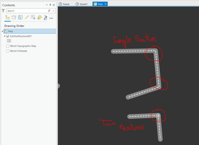

 I don't think there is currently any way to avoid the dark shaded area caused by overlapping in Native SDK.
I was comparing Native SDK behavior with ArcGIS Pro and noticed that in ArcGIS Pro single feature does not cast shadow but multiple features will result in overlap shadows.
Image above is from ArcGIS Pro that shows that if it is one geometry , it displays without overlaps at connecting vertices but if there are different geometries , it would cause the darker shade at overlaps.
Unfortunately it is not same in Native SDKs. I will look further and see if something can be done in Native SDKs to achieve the same behavior. I will also log an issue internally for us to look into this further. If I find any workarounds I will let you know.
