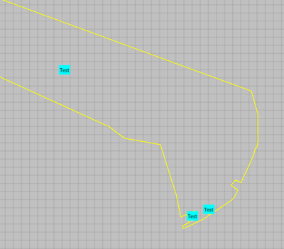

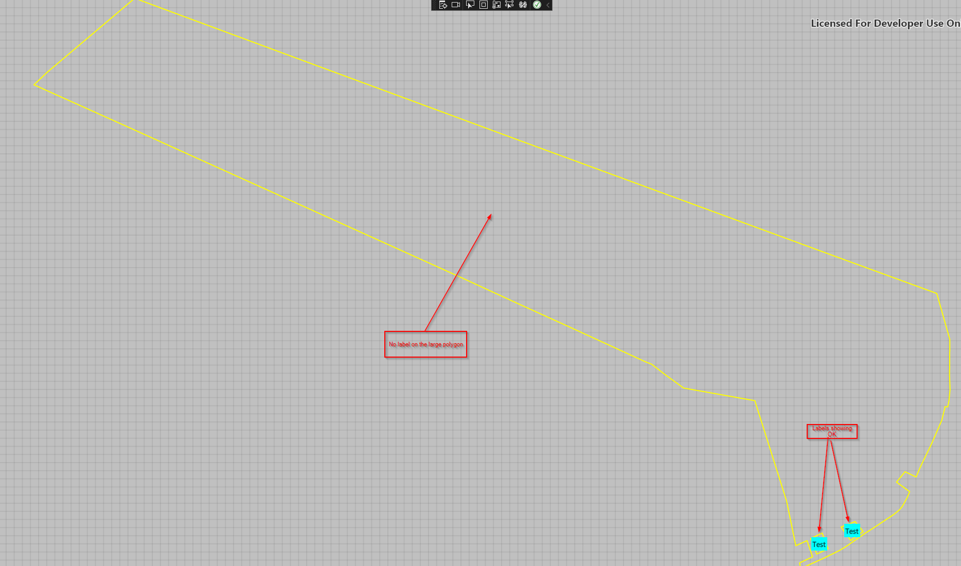

Some polygons don't display the label that is specified on the overlay.
I have extracted some code to a demo project that shows the problem. I have added three polygons to an overlay and added a symbol renderer and a label definition. The large polygon doesn't show the label.
Code extract (see full demo in attached zip):

Calling "poly = GeometryEngine.Simplify(poly);" on your polygon before adding it to the GraphicsOverlay should resolve the issue.
        private void addPolygon(string polygonJson)
            var poly = Geometry.FromJson(polygonJson);
            var graphic = new Graphic
                Geometry = GeometryEngine.Project((Polygon)poly, new SpatialReference(3006))
            testLayer.Graphics.Add(graphic);

Have you checked that your geometries are OK? An invalid geometry will display on the map but won't show a label. If this is what's wrong, running the RepairGeometries tool should solve it.
https://desktop.arcgis.com/en/arcmap/10.3/tools/data-management-toolbox/check-geometry.htm
https://desktop.arcgis.com/en/arcmap/10.3/tools/data-management-toolbox/repair-geometry.htm
