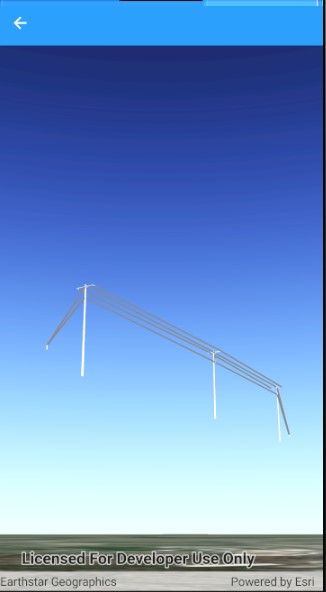

The biggest issue is that in the Xamarin Forms app, the KMLLayer is not draped on the surface even though we've setup the elevation surface and set the base surface. We're using the same code on Windows and in the Xamarin app however in the Xamarin app the KMLLayer appears to be "floating" in the air.

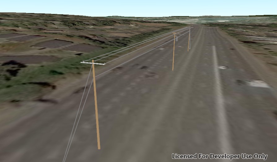

Here's an example from Windows app showing it correctly displayed.
Here's a screen shot from the Xamarin Forms app using the same code to setup the surface as well as the same KMZ file.

It looks to me the surface isn't loaded in your mobile app. Are you hitting an http or https service? Note that both android and ios by default blocks http services now, so could just be the surface data fails to load.
MikeBHamsa
Thank you. That was the issue. It works perfectly.
