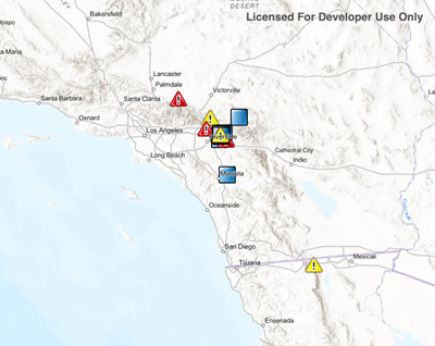

Feature classes should reproject to the spatial reference of you map.  This is an example of a feature service in WGS 84:
https://sampleserver6.arcgisonline.com/arcgis/rest/services/LocalGovernment/CitizenRequests/FeatureS...
I've basically taken this sample and swapped out the service and it displays.
If you've got issues with reprojecting feature services then I'd suggest starting a new post.
