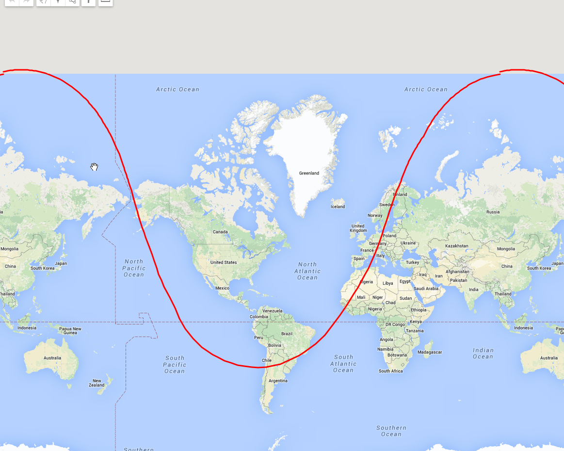

I'm trying to create a range map based on coordinates.  Whether I do it with code or by KML file in ArcGIS, my results are way different than importing the same exact KMLfile in Google Maps.  Any advise on correcting this to look more like Google Maps?  Keep in mind this application is ran completely offline, which is why I cannot use Google Maps

Google Map View:

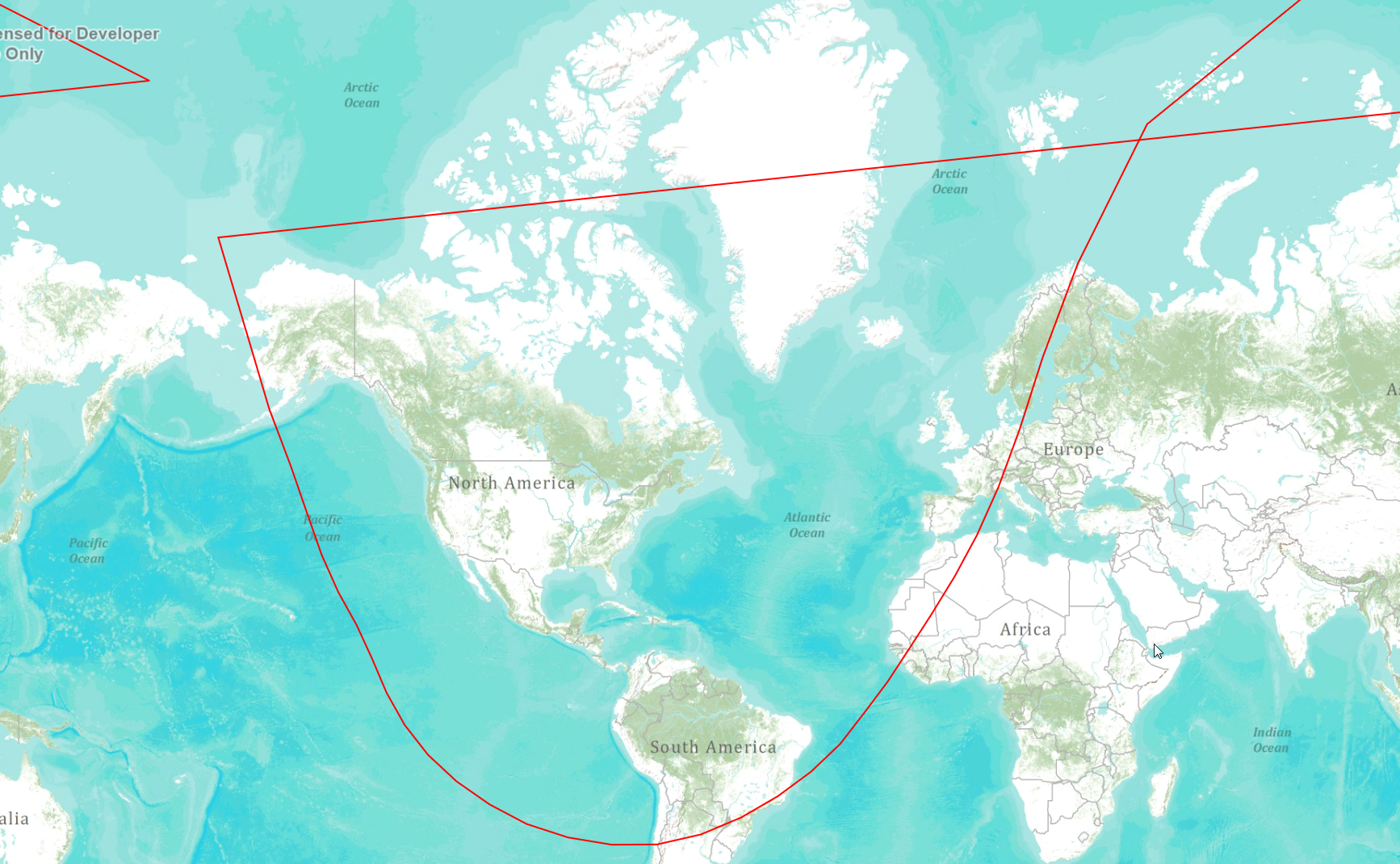

ArcGIS View:

I don't know how to fix it in Runtime, but you have coordinates that are 'above' the valid latitude for EPSG::3857 (Web Mercator) and the line is crossing the dateline aka +/-180.

Just had a play with this in ArcMap.
Arc draws the points in their order, so I just edited your coordinate list. Those last 2 at the beginning. Then I deleted 98.93,85.17 because it is very close to another point. Alos when you construct a line from these points, arc just connects the dots. So the part through SAm looks relatively smooth, but that over northern Russia has only a couple of points. I tried the smoothing functions in the Cartography toolbox, but Bezier or paek smoothing options didn't quite do it. You need a curve fitting algorithm, I know that Ianko's ET Geotools has these.

I don't believe it's the order of the coordinates.  If I import it into the 3D Scene View it displays as a complete circle, which it should.  I did move the two coordinates at the bottom to the top.  If the range was much smaller, it should give me a range circle on the 2D Map.  I can post an example of a smaller range circle.

Hi,
Moving the 35th and 36th coordinates to the start of the list (and maintaining their order i.e. 35, 36, 1, 2...) gives the following:
It looks better on a WGS84 basemap:
Note I set the opacity of the basemap to 0.25 to give greater clarity.
