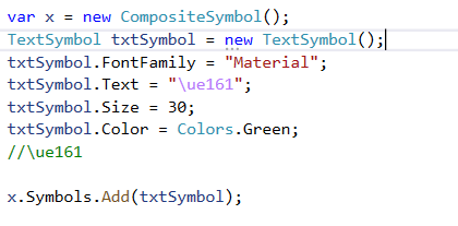

I want to set a symbol(which is coming from MaterialIcons-Regular.tff) to the graphic that i am creating in Xamarin forms. As in xamarin, by setting the fontfamily to Material-xxx.tff works fine for labels, Text. I want the same to be applied for Garphic in TextSymbol.
Material is an Alias Name given for the MaterialIcon-Regular.tff. After this I am setting this symbol to the graphic.

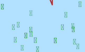

and the response i am getting is::
Any help would be much appreciated.
