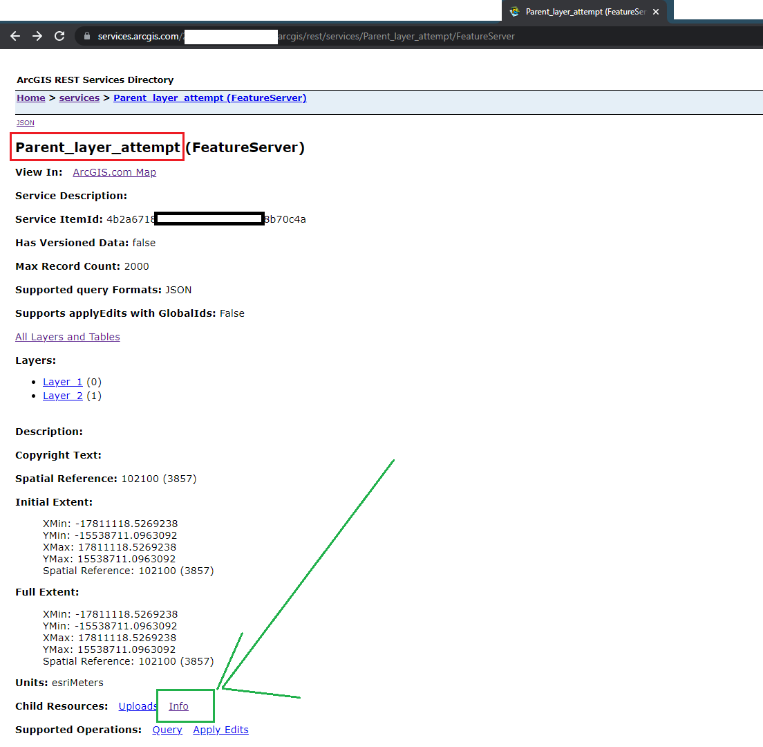

On the web interface I can see the name of the Feature service (in red) and the service ItemID.
How do I get any of these out of the ServiceGeodatabase object? I have looked all over the place but can't find it.

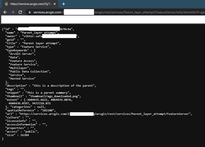

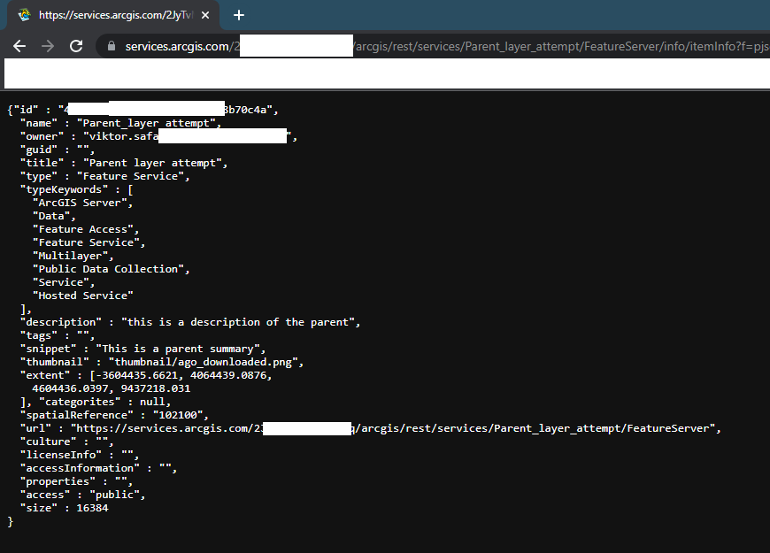

There is also the Info child resource (green) which then provides an ItemInfo child resource where there is a lot of information. Are these accessible via the Runtime API or do I need to make an HTTP call to .../FeatureServer/info/itemInfo?
