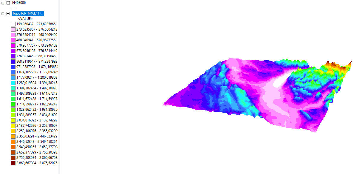

How to create 3d surface in .net wpf using isolines or tiff data file? To get something like that 3d surface on picture but in the wpf .net application
