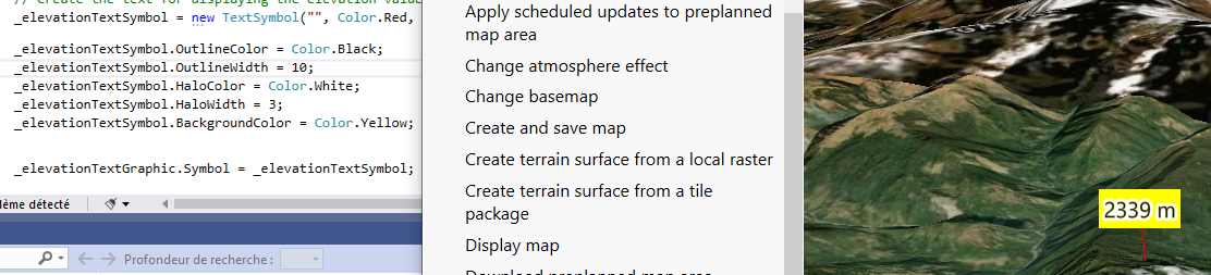

I tried with the 100.8 sample (GetElevation from a point)
It's possible to initialize a BackgroungColor , an OutlineColor, a Halo
But none of the combinaison I tried can display de border of the background with n other color.
