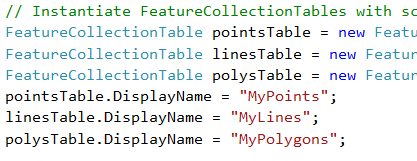

I added a few lines to set DisplayName in the CreateFeatureCollectionLayer.cs file in the samples ...

I don't see any of the DisplayNames in the json file. (see attached)
How can I get the DisplayNames to be included when I serialize (and deserialize)?
