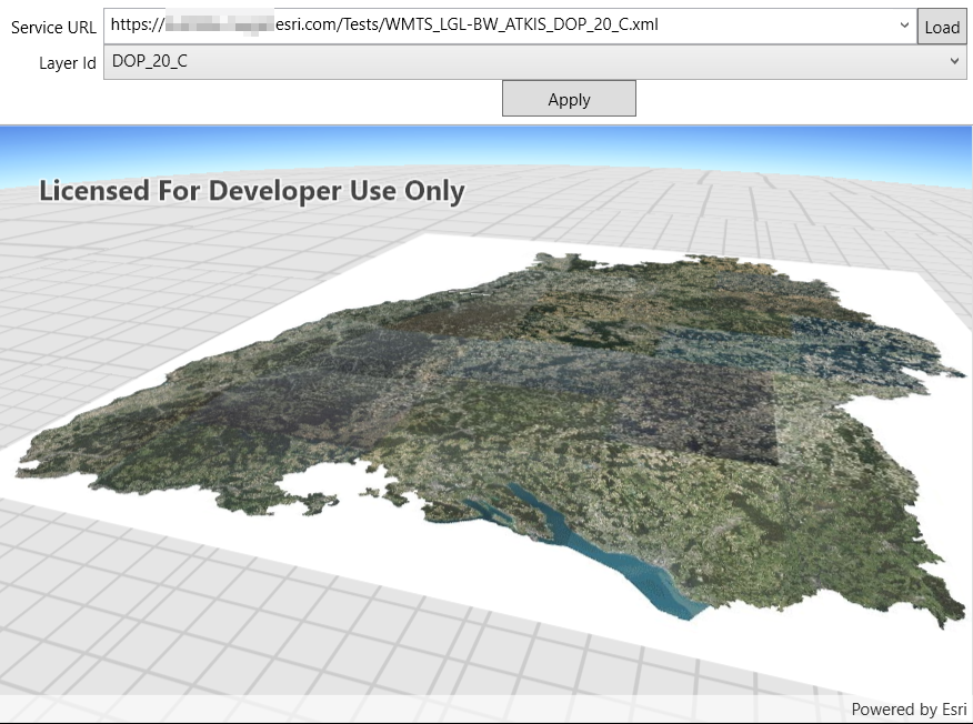

Runtime needs ows:Constraint to determine which message-encoding to use for the service (KVP or RESTful).  Looks like this service is powered by a very old version of OpenLayers, which used to omit this required piece of metadata from its capabilities.  The bug was fixed in OpenLayers v4.6.0 (2017): https://github.com/openlayers/openlayers/issues/6835
If you have any control or influence over this service, I recommend upgrading the server software!
The simplest workaround would be to download this server's capabilities document, edit it to be standards-compliant, and re-host the XML file yourself.  The capabilities document specifies absolute URLs for loading tiles, so it doesn't matter to Runtime where it was loaded from.  I edited the file and hosted it on the local network as a proof of concept -- it worked!
And here is the edited OperationsMetadata section that I used:
