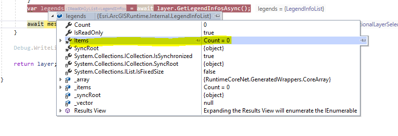

RomanBoros
Thanks for your response. After trying GetLegendInfosAsync () on the sublayer it returned null as a result and Status as Waiting for Activation. Anything we need to configure on on the Tile Service? see below snapshot
DominiqueBroux
Esri Frequent Contributor
'await' is missing in your code, the task is not executed yet at your debug point.
var legend = await sublayer.GetLegendInfosAsync();
