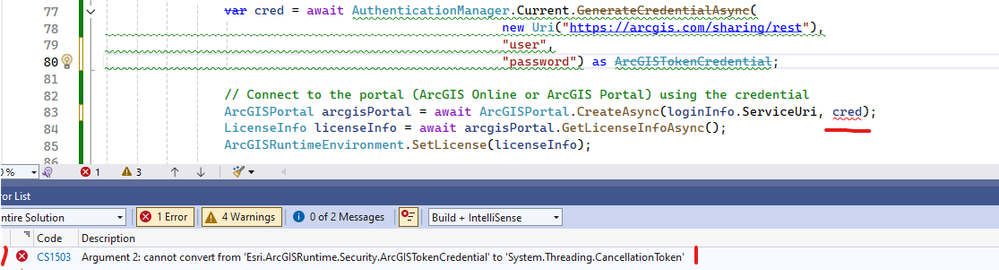

MatveiStefarov
The overload of CreateAsync that takes a specific credential has indeed been deprecated and removed.  In general, instead of passing/setting a specific Credential on your portal or layer, you should just add it to the AuthenticationManager.  Here is how you can accomplish your portal login in 200.x:
var cred = await AccessTokenCredential.CreateAsync(
                new Uri("https://arcgis.com/sharing/rest"),
                "user",
                "password");
AuthenticationManager.Current.AddCredential(cred);
ArcGISPortal arcgisPortal = await ArcGISPortal.CreateAsync(cred.ServerContext, loginRequired: true);
// the rest is unchanged

Azamat
@dotMorten_esri ,
I mean that the project does not compile. Please look at the screenshot of the code with the warning that prevents compilation:
I tried to change it but it didn't work 😞
Thank you.
Best regards, Azamat
MatveiStefarov
                "user",
                "password");
Azamat
@MatveiStefarov , thank you very much, I'll be know.
Finally, it works.
