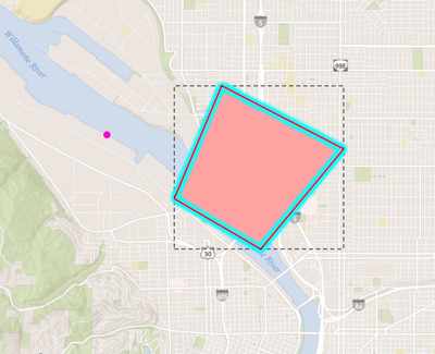

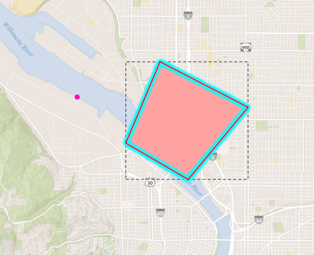

SelectGeometry() called on editor, with Geometry property set to a polygon:

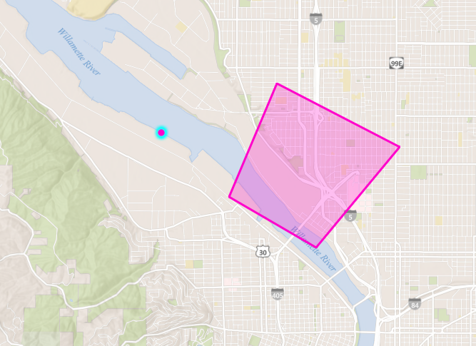

SelectGeometry() called on editor, with Geometry property set to a point:
