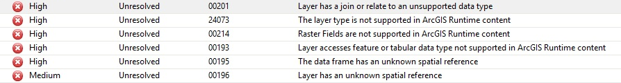

What that mean? Is even possible load .gdb in v100.1? I found some examples with .geodatabase for v100.1, but when i want generate it in ArcMap (ArcGIS Runtime Content) it show few errors.

I am new to ArcGIS Runtime too, but I haven't found that you can load ".gdb" databases to Runtime application. I have made my ".geodatabase" file from ArcMap. At startup I have got errors like you, but I checked and eliminated errors.

File Geodatabases aren't supported. You will have to export the data to an "ArcGIS Runtime Geodatabase" (using the ArcGIS Runtime Content tool) for it to work.
