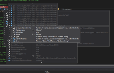

when the locator task is loaded the following can be seen in the ResultAttributes

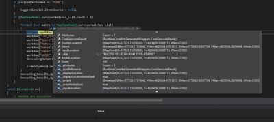

The result only returns the following info
When using the locator through ArcGIS Pro i get all the available info. It appears that .net locator task returns only PlaceName.
