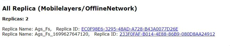

What I notice is that when I look at ArcGIS Enterprise at the /replica (https://serverName.domain.loc/server/rest/services/Mobilelayers/OfflineNetwork/FeatureServer/replica... endpoint on the feature service there are two replicas created
When I look at the .geodatabase generated it seems that the file always points to the second one.  I am using branch versioning for the first time, is this expected behavior with branch versioned data?  With standard archive data only a single replica was ever created (same tool, different ArcGIS Enterprise)

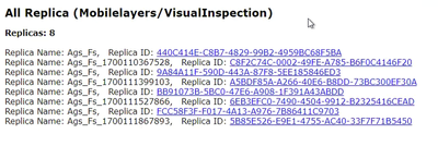

Looking at other things, last night I ran my tool four times on a service I have (single feature class).  I have eight replicas show in the ArcGIS Server UI.  The first one in each set named Ags_Fs

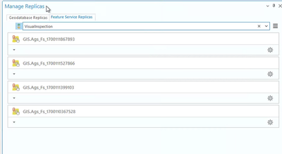

Another strange thing I notice, if I look in Pro the only ones I see are the ones that have none Ags_Fs names:
Thanks,
-Joe
