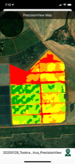

In the following code on SDK 100.xxx on an IOS device, FullExtent is populated to 180, 90, -180, -90 which does not really help when you're trying to zoom to a layer.
FullExtent for this layer should be returning 18.8404922485352, -33.0619621276855, 18.8464298248291, -33.0554275512695
The KMZ layer loads and displays on the SceneView no problem.
The below code snippet results in:
2020-02-12 07:08:50.546 PrecisionView[779:912352] Extent: Xmax 180, Ymax 90, Xmin -180, Ymin -90
As a workaround, I'm having to load and read the coordinates from the actual file which is an unnecessary performance hit.
Is FullExtent not populating a known bug or what am I missing to get FullExtent of a layer to populate correctly?
