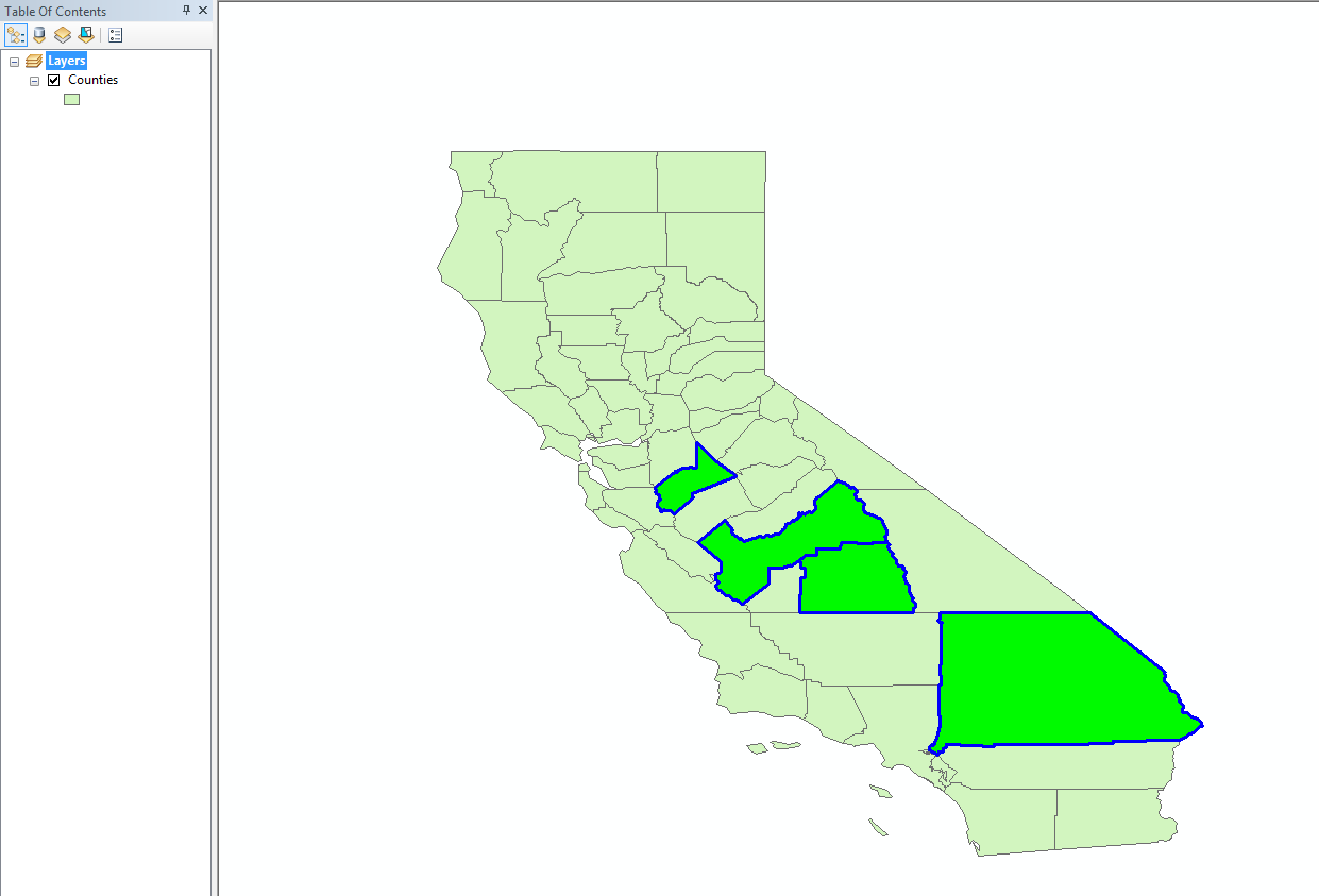

Hi Oliver,
The following VBA sample is able to set the selection symbol to be solid green:
Public Sub SetSeleSymbol()
    Dim pMxDoc As IMxDocument
    Set pMxDoc = ThisDocument
    Dim pMap As IMap
    Set pMap = pMxDoc.FocusMap
    Dim pFeatLayer As IFeatureLayer
    Set pFeatLayer = pMap.Layer(0)
    Dim featSel As IFeatureSelection
    Set featSel = pFeatLayer
    Dim polySym As ISimpleFillSymbol
    Set polySym = New SimpleFillSymbol
    Dim pColor1 As IRgbColor
    Set pColor1 = New RgbColor
    pColor1.Red = 0
    pColor1.Green = 250
    pColor1.Blue = 0
    Dim pcolor2 As IRgbColor
    Set pcolor2 = New RgbColor
    pcolor2.Red = 0
    pcolor2.Green = 0
    pcolor2.Blue = 250
    Dim pLineSym As ILineSymbol
    Set pLineSym = New SimpleLineSymbol
    pLineSym.Color = pcolor2
    pLineSym.Width = 2
    polySym.Color = pColor1
    polySym.Outline = pLineSym
    featSel.SetSelectionSymbol = True
    Set featSel.SelectionSymbol = polySym
End Sub
Results will be like this:
