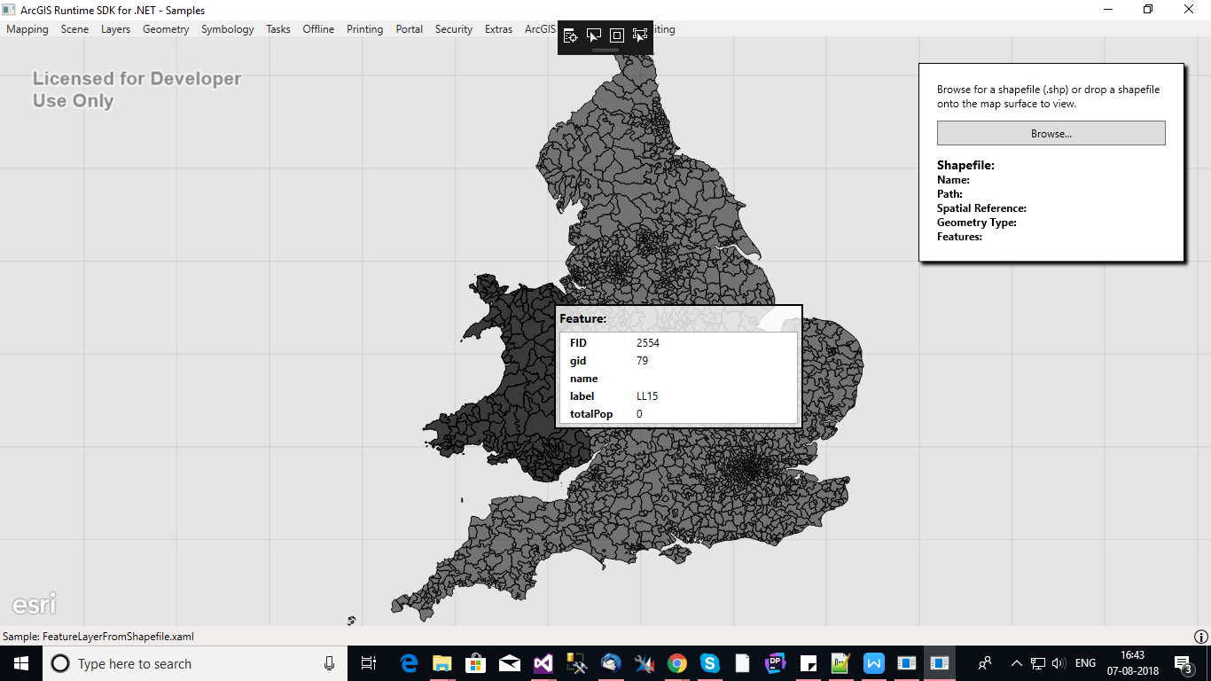

Hello EveryOne ,
I am New on this Platform so please tell me the solution for   display popup on tapped click in Feature layer for WPF
100.3.0.0 sdk .
Description:
i just want to show information just like 10.2.7.0 feature layer tapped click event in WPF solution.
Thanks .

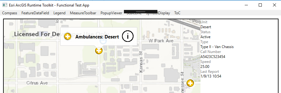

We are still working on a toolkit for this but you should be able to do something like this now with v100.3 providing your own UI. In this sample, we use identify to get to the popup and callout to display basic information on the feature. Once info button is clicked, you can have a viewer that binds to PopupManager properties like DisplayedFields. It's still work in progress but something like this for your UI.

and this, you can certainly improve how you present the fields.
