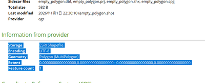

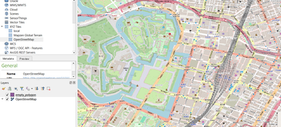

Hello, I edited an empty shapefile using ShapefileFeatureTable.
However, when I checked the shapefile in QGIS, no geometry was displayed, even though the shapefile actually contains a polygon.
It looks like ShapefileFeatureTable does not update the extent of the shapefile, is that correct?
Here is the output of ogrinfo:
$ ogrinfo -al -so test.shp
INFO: Open of `test.shp'
using driver `ESRI Shapefile' successful.
Layer name: test
Metadata:
DBF_DATE_LAST_UPDATE=2025-12-17
Geometry: Polygon
Feature Count: 1
Extent: (0.000000, 0.000000) - (0.000000, 0.000000)

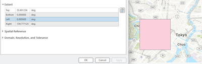

RossMcguyer
It appears that some tools, including ArcGIS Pro and Google Earth, are able to read a shapefile with an incorrect extent, whereas QGIS fails to do so.
I would be hesitant to conclude that Google Earth Pro and ArcGIS Pro are working despite reading an incorrect extent. Examining your shapefile in both applications indicates that the extent is being updated to the expected values, and the polygon is rendering. I can also see (after setting some breakpoints in your code using Visual Studio), that the extent of the table is updated after calling AddFeatureAsync. I have also verified that running the program again and reading from the modified shapefile that the table that is created has the expected extent.
Is this a QGIS-side issue?
Given that your code works in 3 separate instances (including one non-Esri application), I have to conclude that this is an issue with QGIS, or perhaps OGR, as that is the "provider" for QGIS. Other shapefiles seem to work fine with QGIS, so at a glance it seems as though QGIS, or OGR, is incapable of reading the updated extent of the shapefile table. This is unfortunately the limit of my expertise, as I am not in a position to know how QGIS reads and interprets shapefiles.

@RossMcguyerI appreciate you checking my code.
I also checked the file at \bin\Debug\net9.0\data\empty_polygon.shp.
The polygon itself was saved correctly, but the extent was not updated, as shown below.
ogrinfo -al  -geom=YES empty_polygon.shp
INFO: Open of `empty_polygon.shp'
Layer name: empty_polygon
Metadata:
  DBF_DATE_LAST_UPDATE=2026-01-01
Geometry: Polygon
Feature Count: 1
(****************some lines omitted**********************************)
OGRFeature(empty_polygon):0
  level (Real) = 3.000000
  POLYGON ((139.757125 35.671236,139.757125 35.691236,139.777125 35.691236,139.777125 35.671236,139.757125 35.671236))
RossMcguyer
TaroShibata
@RossMcguyer
It seems that OGR-based libraries are unable to read the extent of a shapefile updated by ArcGIS Runtime as pyshp and goshp  can also read it .
