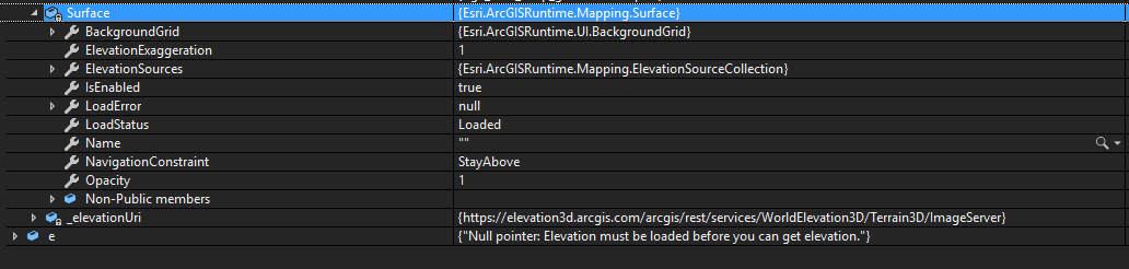

Hi,
I am trying to get the elevation at a point using code very similar to Get elevation at a point | ArcGIS Runtime API for .NET | ArcGIS Developer.
However the following throws an exception "Elevation must be loaded before you can get the elevation".
I am behind a proxy, could that be getting in the way of this working?

Stack trace:

Thank you for reaching out to us. After taking a look at your code, I have a quick question.
Where are you calling your `GetElevation()` from? Without getting a broader context, it seems like you are loading the surface on a different thread than where you're trying to get the elevation from the surface? What happens if you move these two lines
var point = new MapPoint(83.9, 28.42);
var elevation = await Surface.GetElevationAsync(point);
 to after the
await Surface.LoadAsync();
in the InitializeAsync() func?
