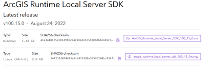

What I see is only v.100.15.0.   Where can I find 200.1 version?

Hi,
I hope you've found it by now, but the download is now listed under the new name "ArcGIS Maps SDK for Local Server" along with the wider rebranding of the ArcGIS Runtime SDKs to ArcGIS Maps SDKs for Native Apps.
