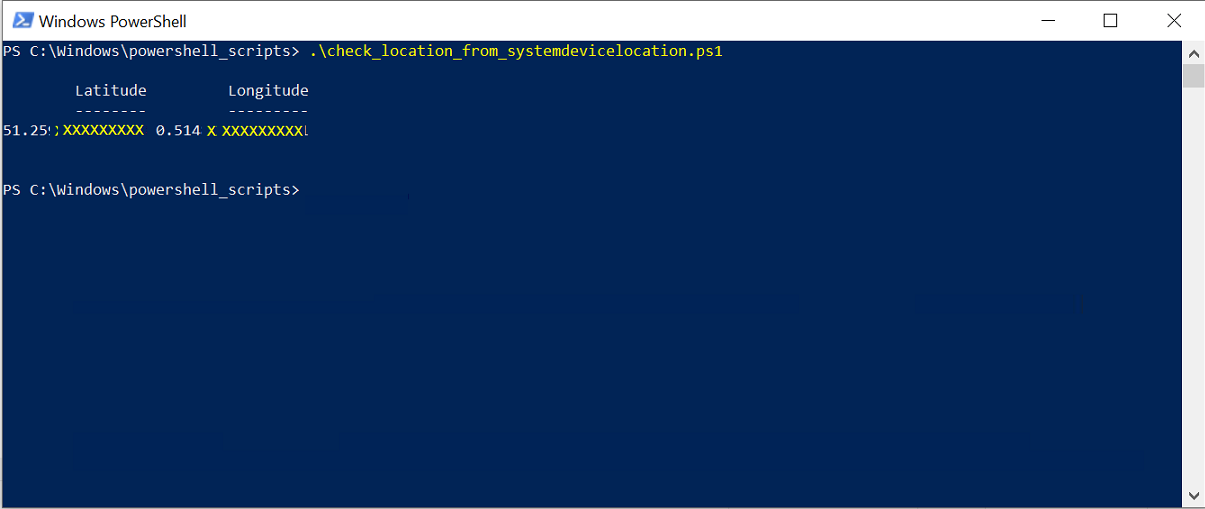

Using System.Device.Location.GeoCoordinateWatcher using the powershell script below to capture GPS coordinates at the same time returns Lat 51.25, Long 0.514)
Powershell code below
Add-Type -AssemblyName System.Device
$GeoWatcher = New-Object System.Device.Location.GeoCoordinateWatcher
$GeoWatcher.Start()
while (($GeoWatcher.Status -ne 'Ready') -and ($GeoWatcher.Permission -ne 'Denied')) {
    Start-Sleep -Milliseconds 100 #Wait for discovery.
$GeoWatcher.Position.Location | Select Latitude,Longitude
See: https://learn.microsoft.com/en-us/dotnet/api/system.device.location.geocoordinatewatcher?view=netfra...

So the question is why is Powershell returning a different location to ArcGis if they are using the same GPS source.
Does ArcGisRuntime use the same underlying method as our Powershell script does via System.Device.Location.GeoCoordinateWatcher to get the GPS coordinates and is there any logic (e.g. caching etc.) that occurs that would affect the locations from being the same/correct?

Yet, the Powershell script was returning correct location at the same time as above.
Presumably both APIs should return the same co-ordinates.
But if there is caching then this could result in different results at the same time. Is this cached by the Esri Runtime or the underlying API?
We're not using the same API. You're using GeoCoordinateWatcher which is built on the older Windows Location APIs that has been deprecated. We're using WinRT's more modern GeoLocator in the Windows.Devices.Geolocation APIs, which might also be pulling from IP, WiFi, Celltowers etc to get a quick first location fix. You should be able to tell the origin of the location in the AdditionalSourceProperties property, although it is a bit dependent on your system's Location driver whether that'll get populated. The HorizontalAccuracy property might also be an indication of what kind of location fix you got.

I’ve been looking at the additional properties and as you say they depend on underlying API and driver to provide details. I’ve had mixed results but mainly LocationSource is returning Wifi even when using GPS dongle and doesn't always provide any other clue. Most importantly we’re unable to force any refresh of cache or only use GPS to get accurate read.
Our issue is that Windows Location Services used as default in Esri has been unreliable – a combination of slow to update and inaccurate location (e.g. WiFi or cached location).
It was during investigating this that we noticed Powershell script was returning more accurate location results (not cached).
