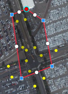

I have a map which has a GraphicsOverlay with various points. I have given the user the ability to select a subset of the points by drawing a polygon using the SketchEditor. How can I determine which points have been selected?

You can use GeometryEngine.Intersects method to decide whether graphic needs to be selected.
For example, in code below. GraphicsOverlay contain points and a polygon geometry is used for selection. Once point graphics are available, draw polygon (double-tap to complete draw), then mark graphic as selected based on return value of GeometryEngine.Intersects method. Geometries might need to be in the same SpatialReference, so you might need to use GeometryEngine.Project.
