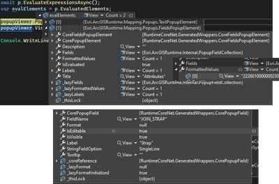

The field name is correct, and I did try a few other fields, including surrounding with [brackets]. I added screenshots while stepping through in case you can see anything.
Fields in the Table and Attributes on the Layer. Then the FieldPopupElement which has the single field item - newF.
Also included how the Table and FeatureLayer are loaded and the exact code used to create the definition.
Thank you for the help on this.

Added the LoadAsync, doesn't appear to make a difference, and EvaluatedElements to the GeoTapped Event.
I can see the 2 evaluated elements, text and field, both have the properties set as expected.
I can even see the correct value when looking at the FormattedValue...But still only the Titles and text field are displaying in the popup.
