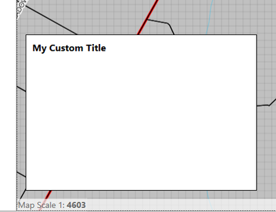

I have a simple Identify Layer tool, that should be displaying information in a popupviewer, however only the Title is being displayed in the PopupViewer Control.
Simplified example is below after following the Configure Clusters sample.
I have tried creating a PopupDefinition in numerous ways but the only thing that displays in the popupviewer is the Title. The rest remains blank. I have to be missing something.

Yes, after adding that line the popup still only displays the Titles and static Text Field elements. The popup definition does have the correct evaluated field values which can be seen stepping through code.

Could you try setting height instead of the maxheight? I wonder if it is rendering, but just not sizing itself right.
HS_PolkGIS
That would have been a nice easy fix but unfortunately, still the same except a bigger popup.
<esri:PopupViewer x:Name="popupViewer" Margin="5" Width="375" Height="250" MaxHeight="400" />

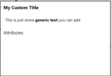

PopupDefinition newP = new PopupDefinition() { Title = "My Custom Title" };
PopupField newF = new PopupField() { Label = "Strap", FieldName = "JOIN_STRAP", IsEditable = true, IsVisible = true, StringFieldOption = PopupStringFieldOption.SingleLine };
newP.Elements.Add(new TextPopupElement("This is just some <b>generic text</b> you can add"));
newP.Elements.Add(new FieldsPopupElement(new[] { newF }) { Title = "Attributes" });
HS_PolkGIS
Making a little progress.
All of the "static" text is appearing in the Popup but I am getting binding errors. All the original code is the same but I used the suggested TextPopupElements and the FieldsPopupElement lines... Adding a AttachmentsPopupElement with displaytype of list did not resolve anything.
The first error happens on app loading and the 2nd happens when the popup is set in the geotapped event. The error seems to be expecting an AttachmentsPopupElement and not the FieldsPopupElement.
